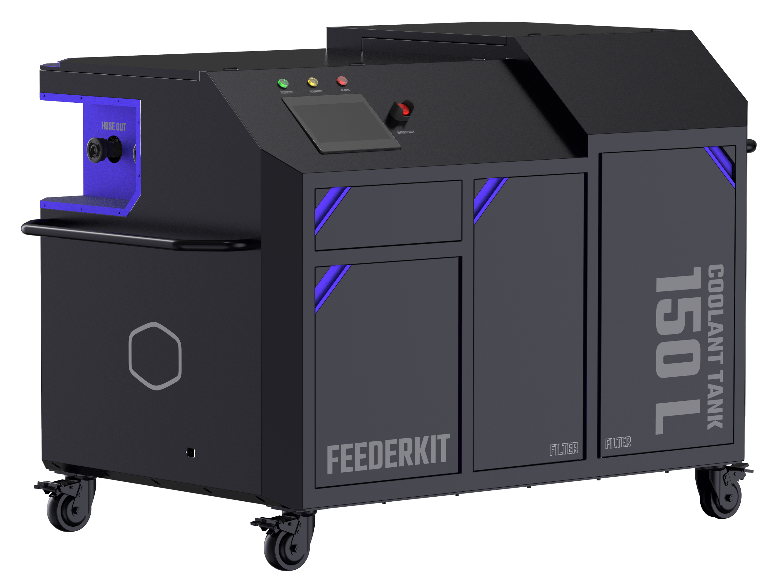

Overview The Feeder Kit is a vital commissioning tool for liquid cooling systems, designed to streamline the coolant filling process for CDUs and rack manifolds. It delivers fast, clean, and controlled coolant flow with features like automatic pressure regulation, quick disconnect fittings, and real-time coolant quality monitoring. With its user-friendly design and replaceable components, the Feeder Kit simplifies setup and maintenance while extending system longevity.
Features and Benefits
Features:
  • 25-micron filter
  • 150-liter coolant tank
  • 40 psi maximum pressure
  • Quick Disconnect fittings
Benefits:
  • Automatic Tank Refilling – simplifies coolant replenishment for optimal efficiency.
  • Coolant Compatibility – works with a wide range of coolants.
  • Automatic flushing & filling – speeds coolant transfer to prevent downtime.
  • Automatic flow and pressure control – ensures safe, reliable coolant replenishing.
  • Flexible Operations - manually adjustable pump RPM and pressure settings.
  • Safety Controls – over-current protection.
  • Quick Disconnect Fittings – provide safe connections with zero spills.
  • Dual Coolant Level Check – a level sensor and level indicator ensure commissioning efficiency.
  • Coolant Quality Monitoring – ensures the longevity of CDUs and loop components.
  • Extended Lifetime – replaceable components extend device lifetime.
  • Easy Maintenance – offers a fully detachable tank cover and ball valve drain.
Fill, Flush, and Flow with Confidence
The Cooler Master CDU coolant Feeder Kit is an efficient coolant and inhibitor filling solution for the secondary loop to the data center IT hardware cold plates and manifolds. Its pump and compressor deliver a 25-micron-filtered coolant or inhibitor at a maximum pressure of 40 psi from a 150-liter tank.

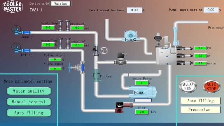

Feeder Kit Control Panel Interface UI
