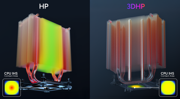

Rethinking Heat Pipe Geometry with 3DHP
It all starts with the geometry of the heat pipe and its heat pipe layout. Most CPU coolers use two U-shaped heat pipes on either side of the cooler. This creates two opportunities: one is in the U-shape of the pipes and the other is in the mirrored placement of the heat pipes. Heat can pool in the middle of the U and between the two heat pipes.
Pooled heat is harder to cool. Fans have to spin up to their max rpm, causing noise and degrading performance over time. The cooler just isn’t as efficient of a design as it could be.

  • • Improved contact efficiency between the CPU and heat pipes
  • • Even heat distribution across the fin stack

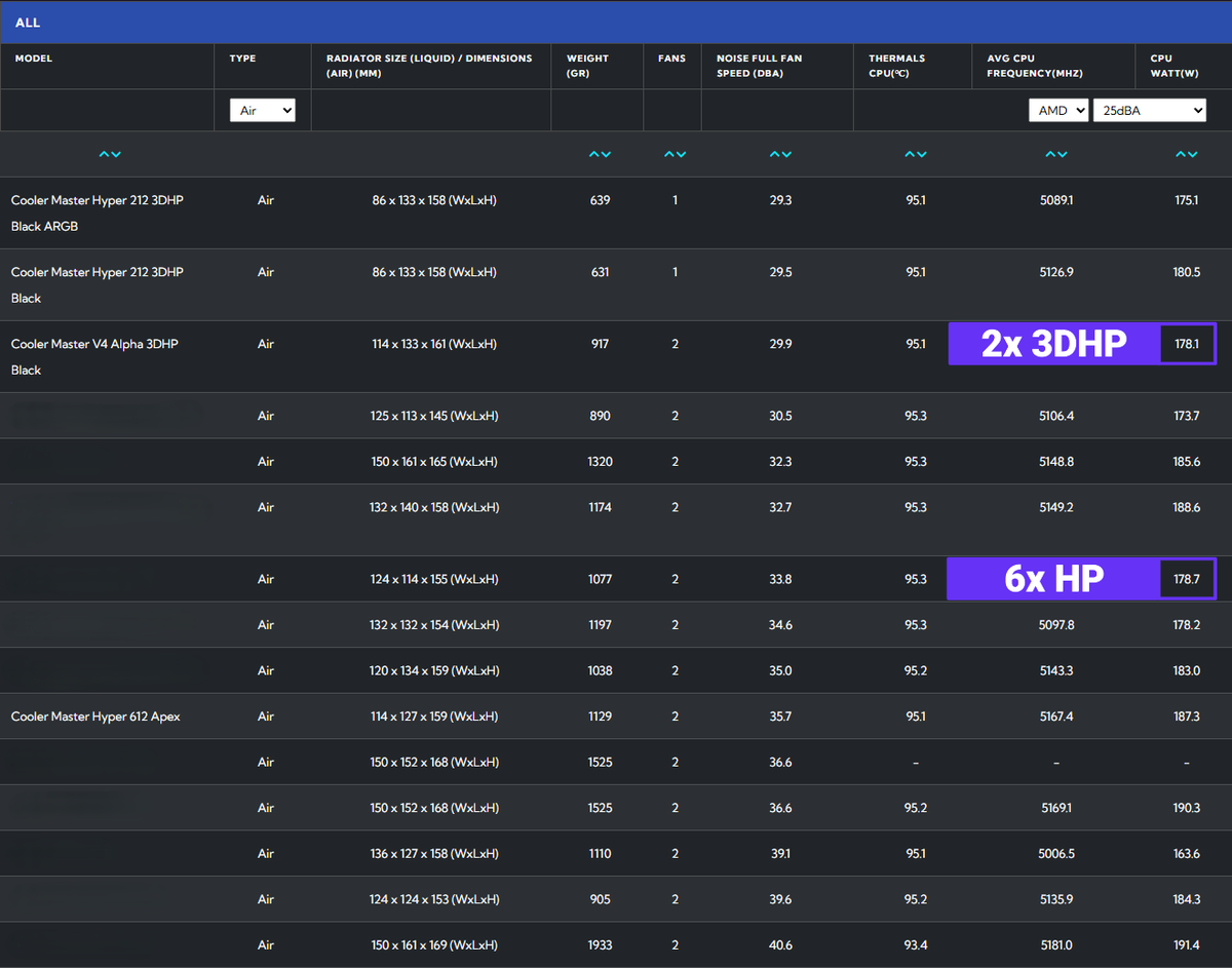

Testing shows 3DHP delivers higher thermal transfer efficiency per heat pipe compared to traditional heat pipe (HP) layouts.
3DHP HP
up to 87 W per pipe up to 34 W per pipe
These results show approximately 2× higher performance per pipe under equivalent noise conditions.*

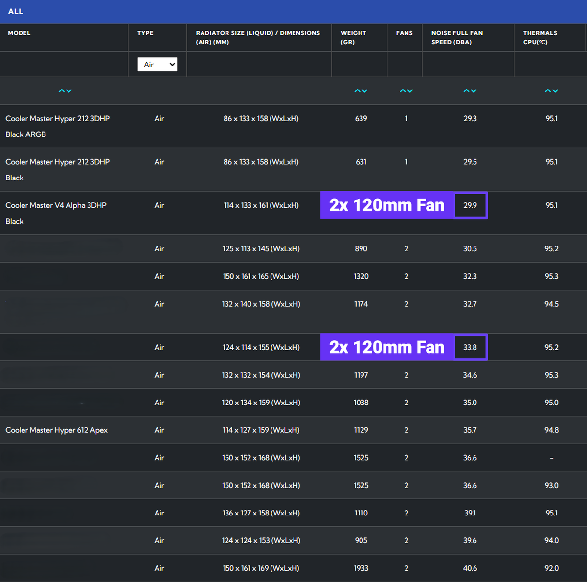

In addition to thermal efficiency, testing also shows less noise.
3DHP HP
up to 29.9 dBA from 33.8 dBA
This represents approximately 35% less noise in equivalent airflow conditions.**
Source: Cybenetics
* Performance difference recorded at 25 dBA noise-normalized testing
** Noise difference recorded at identical maximum fan speed using two 120 mm fans
