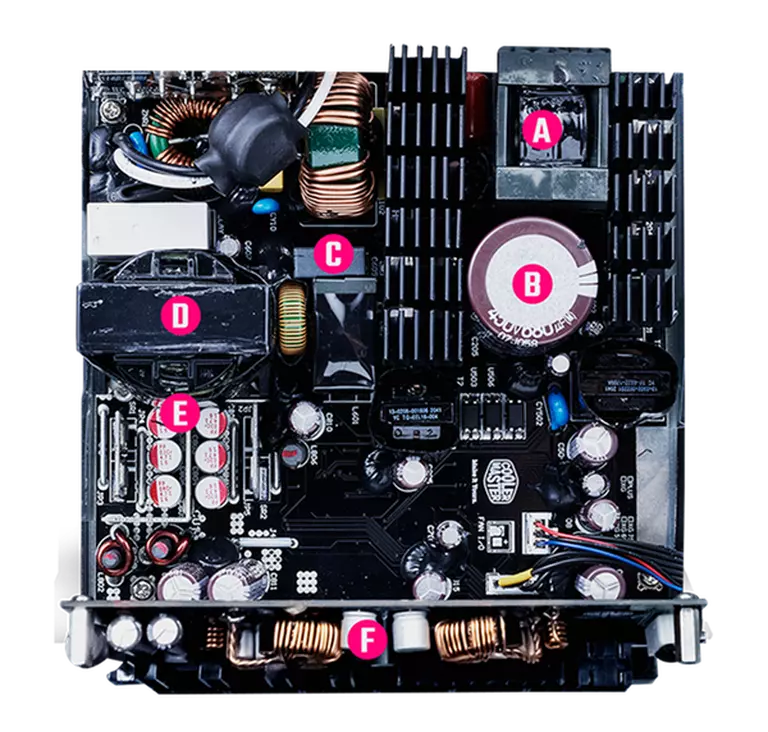

This professional grade power supply unit is built with full-bridge LLC resonant converter and DC-DC technology, made for the all users providing stability, reliability and so much more.
A - High permeability PFC inductors, improve power factor
B - All-Japan capacitor, make XG have longer life
C - LLC Topology makes XG more Efficient
D - Uniquely designed transformer with lower heat
E - High-performance synchronous rectification
F - DC to DC Converter

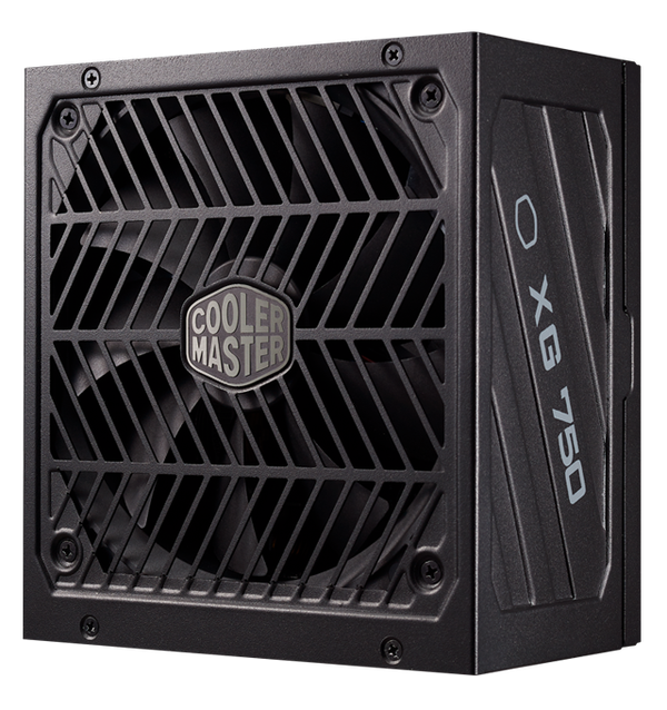

XG750 Platinum has been certified by Cybenetics for both Platinum efficiency and an A++ noise level. It delivers over 92% efficiency at typical loads and maintains an average noise level below 15dB(A) through its smart thermal control system.
