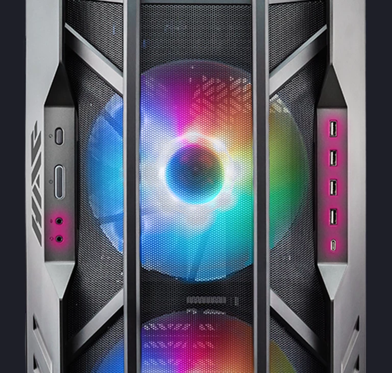

Rich Connectivity
The front I/O is designed to maximize the front connectivity for most high end motherboards, featuring four USB Gen 3.1 Type A ports, a USB Gen 3.2 Type C, a 4 pin audio/mic headset jack as well as a dedicated mic jack.

Exclusive SickleFlow fans
HAF 700 comes with dual exclusive 200mm Sickleflow ARGB PWM "Performance Edition" fans tailored to strike a balance between performance potential and noise levels
Unrestricted Front Panel Intake
HAF 700 sports a fully meshed front panel, specifically designed to allow for maximum air intake. With the front panel structurally reinforced to prevent resonation caused by fan vibrations, systems can run smoothly at minimal noise levels.
