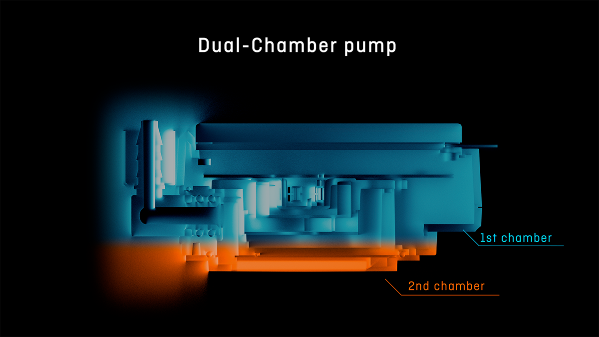

The Dual Chamber Advantage
Traditional AIO coolers rely on a single-chamber pump, where coolant flows through a shared internal space. Cooler Master’s dual chamber pump takes a different approach by separating the coolant flow into distinct paths within the housing. This separation prevents warm coolant from mixing with incoming, cooler liquid before it reaches the copper cold plate. This helps maintain optimal thermal transfer. A central flow channel directs coolant more efficiently, reducing thermal interference and supporting more consistent cooling performance.
By isolating the impeller from the motor stator, the dual chamber design also lowers heat exposure on sensitive components which contributes to overall pump longevity. These enhancements make the dual chamber pump especially effective for systems under continuous load, such as during gaming, rendering or professional workflows.

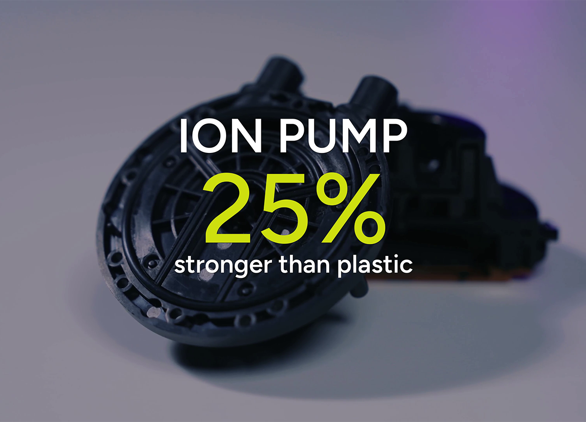

Durability starts with material selection. Our dual chamber pump is made from composite PPS, reinforced with 40% glass fiber for +25% improved strength, improved rigidity and heat resistance compared to conventional plastic.
  • Mechanical Strength: Tensile strength ranges from 180 to 200 MPa, while flexural strength reaches 250 to 280 MPa. These numbers reflect the dual chamber’s ability to maintain structure even under high internal pressure.
  • Heat Resistance: The material can withstand continuous temperatures up to 240°C, and short-term spikes up to 270°C. This ensures stability during long gaming sessions, professional workloads or overclocking.
  • Structural Design: The dual chamber includes internal ribbing around critical mounting areas to increase strength. A 3-millimeter thick outer wall and radial reinforcement ribs help resist deformation under thermal expansion.

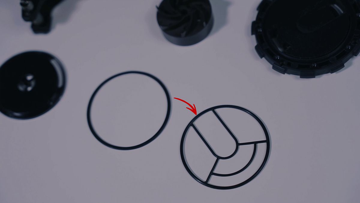

  • O-Rings: The seal rings use EPDM, a rubber compound with excellent chemical resistance and elasticity. It remains flexible from -40°C to 150°C, far exceeding the temperature range of a desktop PC. EPDM also withstands pressure without bending or losing its seal. Its use in demanding automotive systems indicates it will maintain sealing performance well above the operating conditions of a PC cooler.
