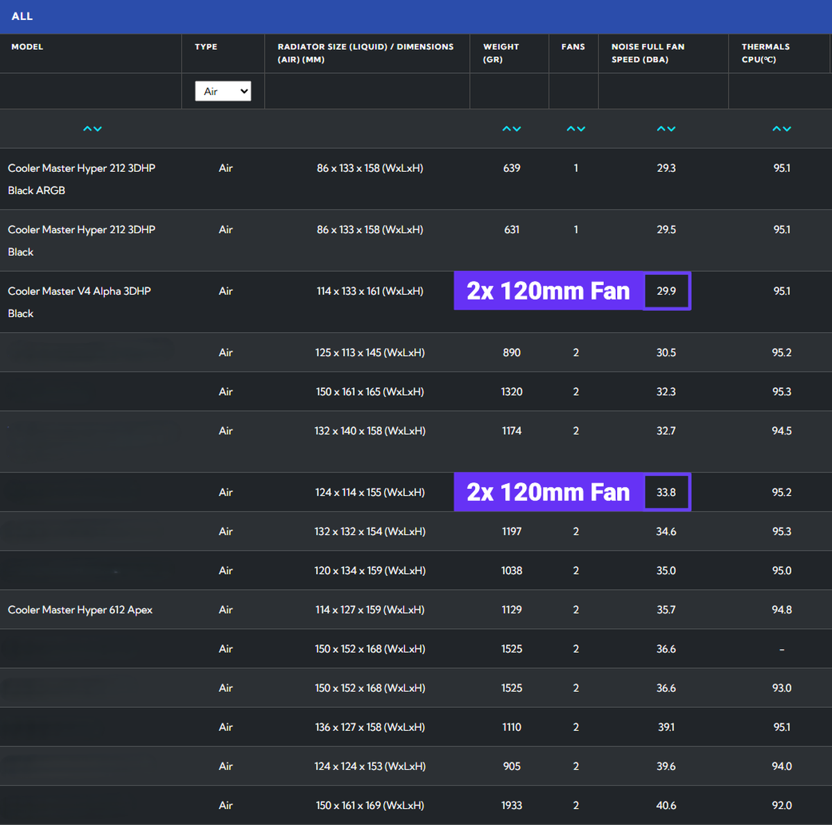

Noise Performance (identical maximum fan speed using two 120 mm fans):
3DHP HP
up to 29.9 dBA from 33.8 dBA
This represents approximately 35% less noise in equivalent airflow conditions.**
Source: Cybenetics
