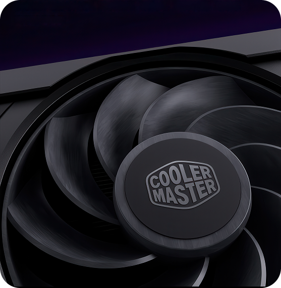

Airflow
Airflow
Two Fans.
Two Roles.
The front and rear fans are engineered for different airflow roles. One builds pressure to push cool air through the heatsink. The other efficiently pulls heated air away. Together, they maximize cooling performance while helping reduce unwanted noise.
Front Fan Standard Blades
Up to 2500 RPM to build pressure through the dense fin stack.
Rear Fan Reverse Ring Blades
Up to 2050 RPM to pull heated air through the cooler while maintaining a clean visible face.
Offset Fan Speeds 2500 RPM/2050 RPM
Different operating speeds help reduce harmonic noise between the two fans.
Exploded dual-fan airflow configuration
LCP Blade Stability
Less Flex.
More Airflow.
Liquid Crystal Polymer provides twice the structural strength needed to resist blade deformation and vibration at higher speeds. That stability maintains tighter tip clearance, reducing air leakage and supporting stronger static pressure.
2× Structural Strength
LCP blades resist flex and vibration at high fan speeds.
Tighter Tip Clearance
Less blade flex reduces air leakage at the blade tips.
Loop Dynamic Bearings
Designed for smooth operation and long-term durability.
