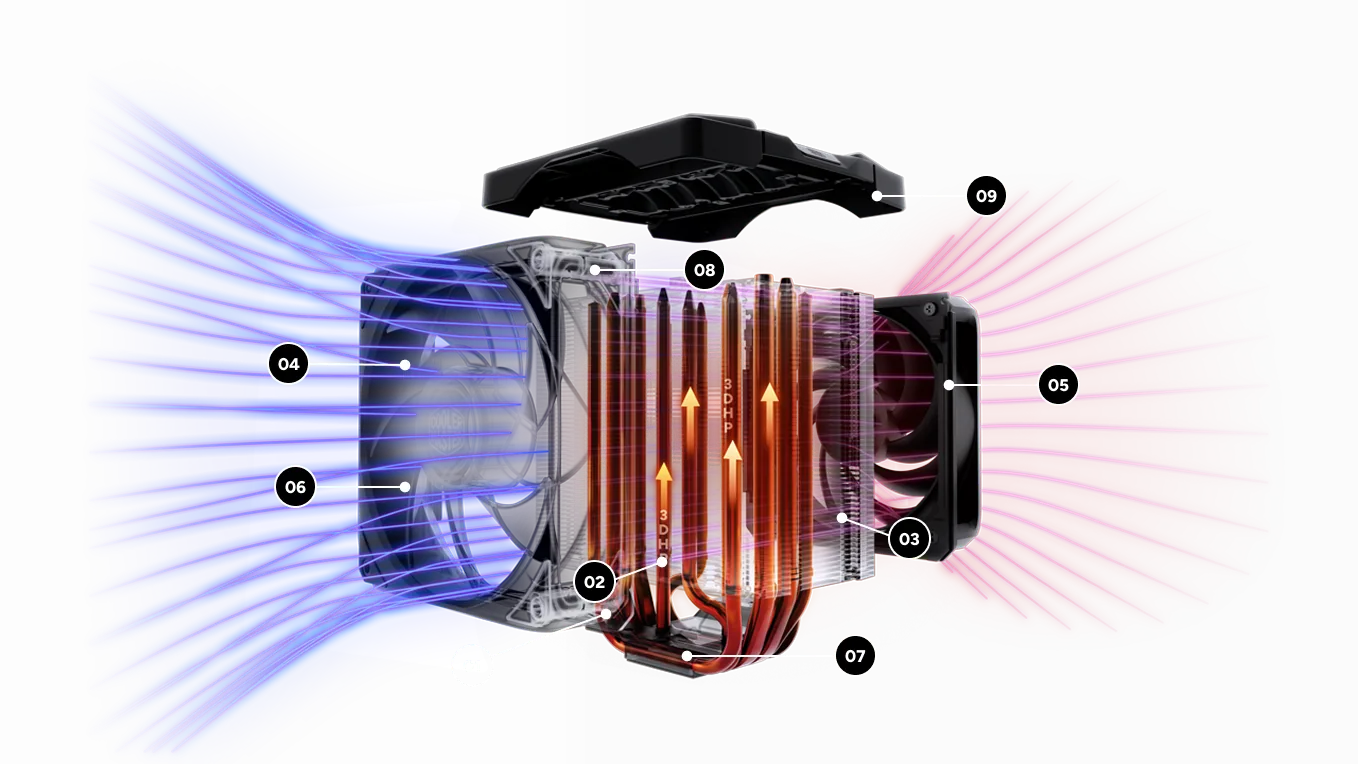

01 / Heat Pickup
3DHP Heat Path
The third branch reaches the CPU hotspot, capturing heat a standard U-shaped heat pipe can miss.
02 / Heat Distribution
Hybrid Heatpipes
Two 3DHP and four SCCHP heat pipes spread heat across more of the fin stack.
03 / Heat Dissipation
Dense Fin Stack
A larger effective cooling surface gives moving air more heat to carry away.
04 / Intake Airflow
Front Pressure Fan
A 120 × 30 mm fan pushes cool air deep into the dense fin stack.
05 / Exhaust Airflow
Rear Exhaust Fan
A second 120 × 30 mm fan pulls heated air completely through the heatsink.
06 / Blade Stability
LCP Blades
Liquid crystal polymer blades resist flex, helping maintain stable airflow at higher speeds.
07 / Platform Optimization
Platform-Tuned Mounting
The base geometry and heatpipe tuning are optimized separately for Intel and AMD processors.
08 / Easy Installation
Sliding Side Fans
Slide the fan clips instead of removing them, supporting memory modules up to 45 mm tall.
09 / V8 Design
Engine-Inspired Top
A bold industrial design inspired by the mechanical character of a V8 engine.

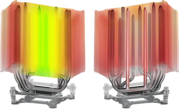

Fin utilization thermal comparison
Higher Fin Utilization
Put More of the
Fin Stack
to Work.
Traditional heatpipe layouts concentrate heat in a smaller area of the heatsink. The hybrid 3DHP architecture spreads heat farther across the fin stack, allowing more of the cooler to participate in heat dissipation.
More Than 95% Fin Utilization
Up from roughly 70% in a conventional layout, based on Cooler Master internal testing.
Reduced Thermal Blind Spots
Heat is distributed more evenly across the fin stack instead of remaining concentrated near the center.
Sustained Cooling Performance
More active cooling surface helps maintain performance during extended workloads.
