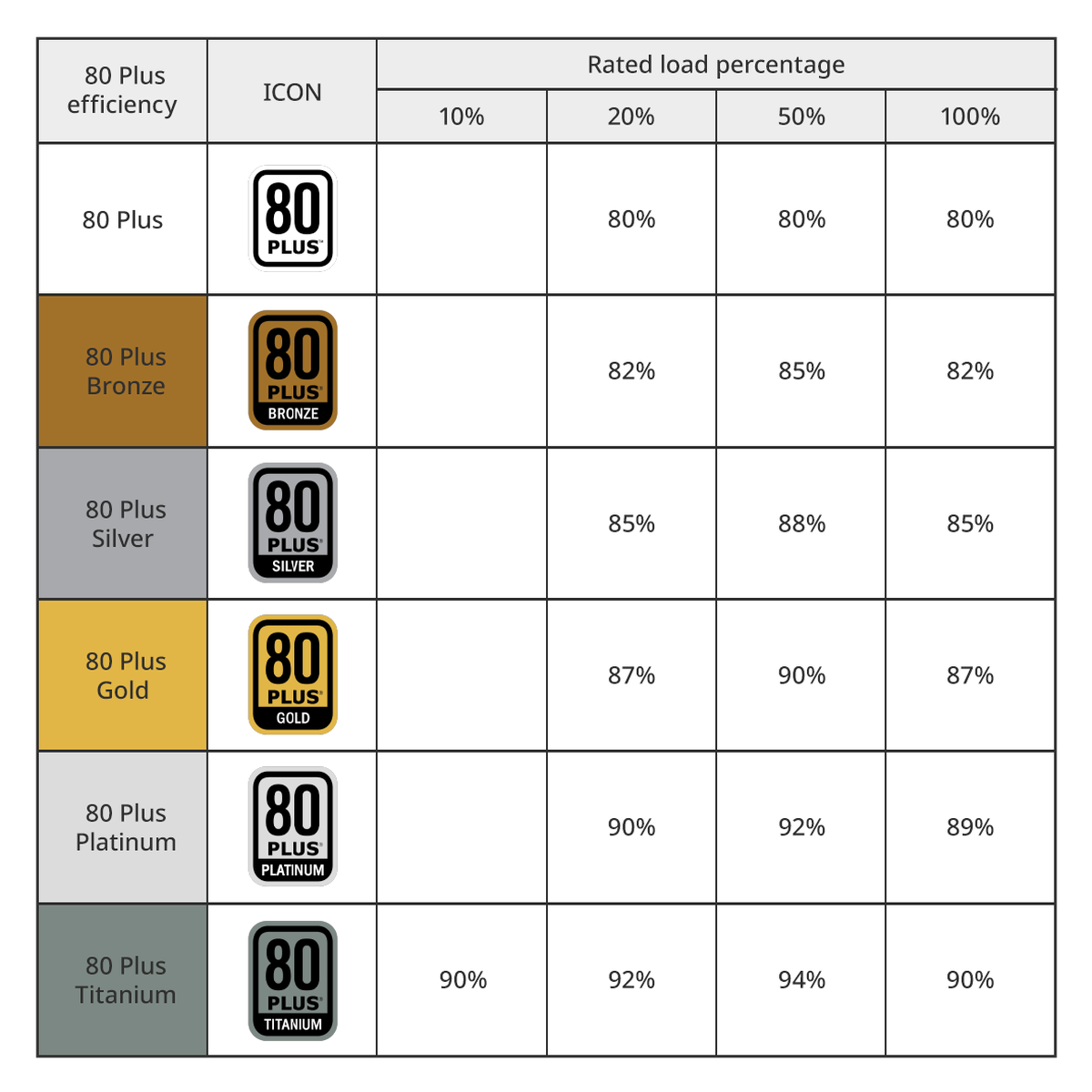

80 Plus is a voluntary certification program that PSU manufacturers can participate in to prove the efficiency of their units. For a unit to be considered for certification at all, it must achieve at least 80% efficiency at 20%, 50%, and 100% loads and feature a power factor of at least 0.9 at 100% load. This is the basic 80 Plus certification. As the certification levels go higher, higher numbers are required. For example, to achieve a Bronze level certification, a unit must achieve 82%, 85%, and 82% efficiency at 20%, 50%, and 100% loads, respectively. See the table below for a full breakdown of each certification level’s requirements:

The Platinum level tends to be a good balance between efficiency, performance, and price. A Platinum rated PSU is highly efficient but goes easy on your bank account. Cooler Master has recently released two Platinum rated PSUs, the V Platinum V2 and the V SFX Platinum. Both units are thus rated to achieve 89% efficiency at 100% loads, ultimately saving you a lot of money each month.
