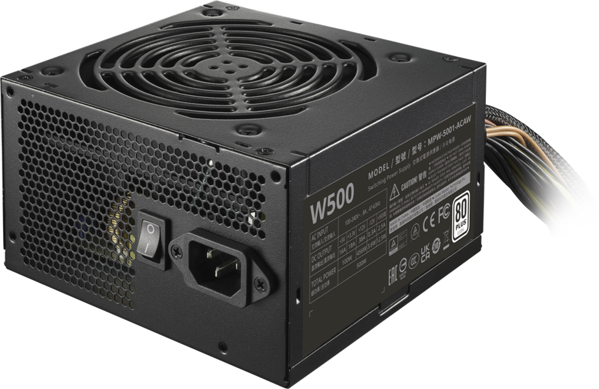

This step only applies to PSUs that feature modular cabling, where all the cables come unattached. If your PSU does not feature modular cabling and all the cables are already attached, you may go on ahead to step 2. If you are unsure, please check out the ELITE NEX White W500 as an example of a PSU with fixed cables.

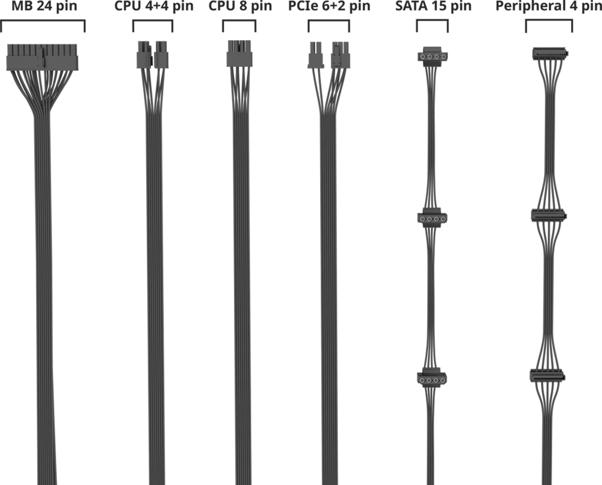

Organize all the cables you received with your PSU and connect the 4 + 4-pin or 8-pin CPU power connector, the PCIe GPU power connector (check your GPU specifications to ensure you connect the correct number of PCIe connectors), and the 1 x 24-pin motherboard connector. Depending on your build you may also need to use a SATA power connector or a second CPU power connector. Be sure to check the manuals and specifications of all your components to ensure you connect every cable you need to the PSU, including the PCIe 6 + 2-pin cable if necessary and any peripheral cables.
