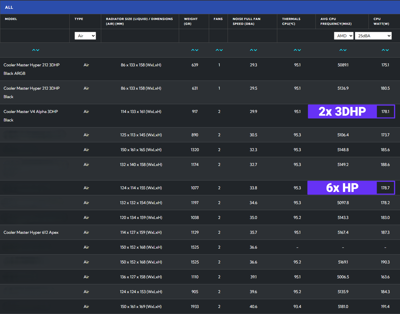

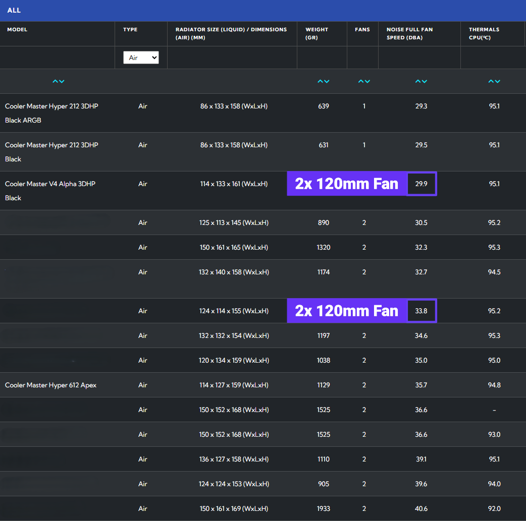

In testing, the 3DHP layout delivers:
• Lower peak core temps in sustained workloads
• Smoother fan response curves
• Improved thermal recovery after load spikes
