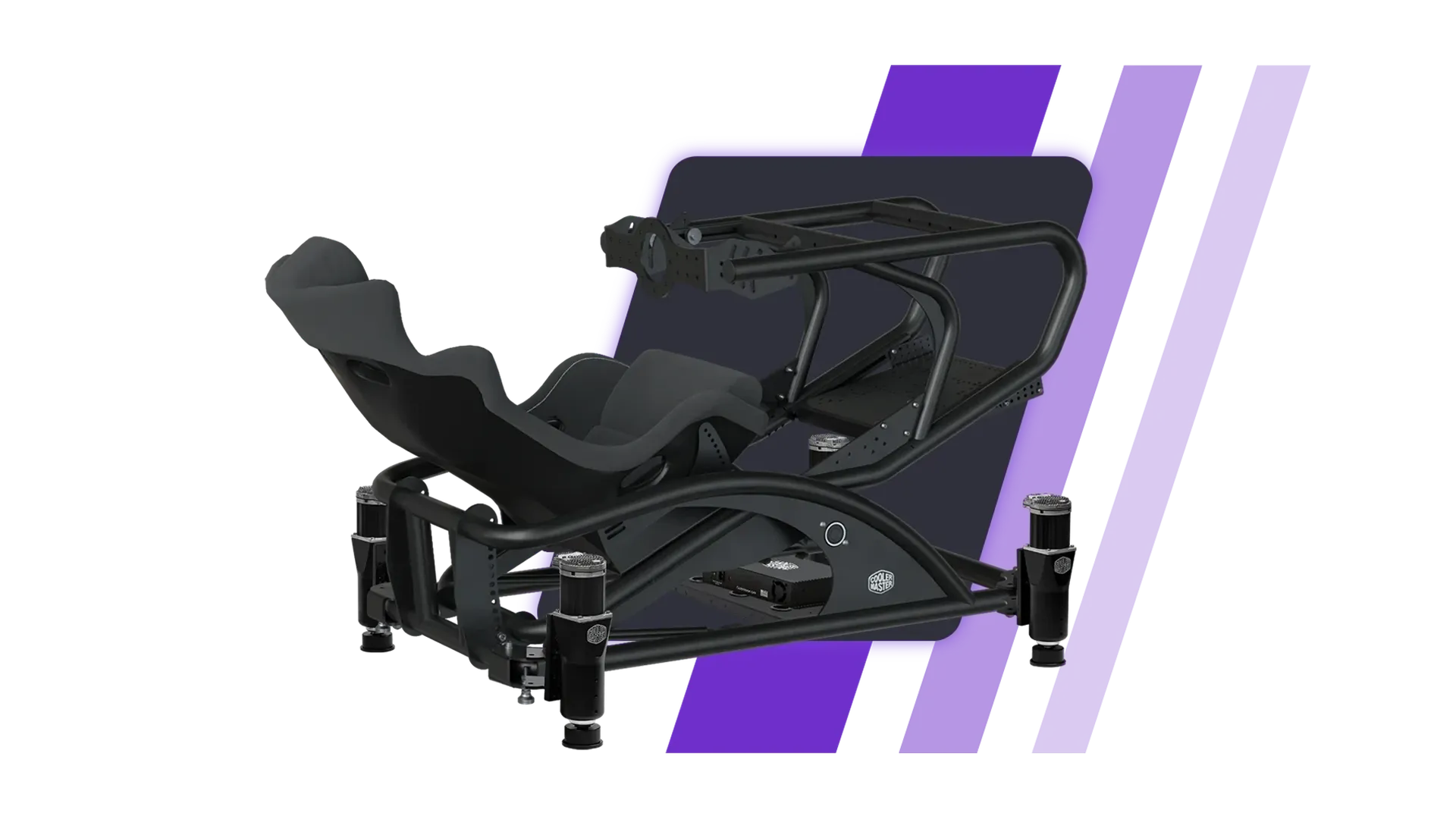

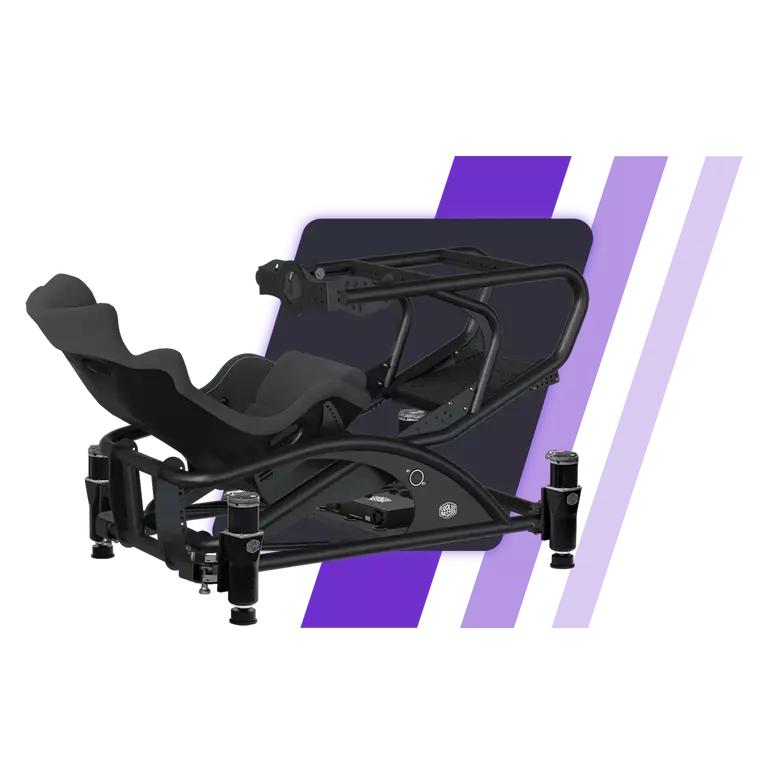

Introducing the Cooler Master Dyn X Motion System: a leap forward in motion simulation, designed for sim racing, and flight simulation enthusiasts and professionals.
Feel Every Track Detail
With larger motors and actuators, our motion system supports more weight and delivers a powerful, torque-enhanced feel, making it ideal for commercial applications. As a highly reliable, industrial-grade system, it offers exceptionally realistic vehicle motion feedback through advanced signal processing. Experience every elevation change, vehicle movement, surface change, and gear shift with unparalleled fidelity.

  • Actuator Travel 2" (50mm)
  • Actuator Speed 7.93"/s @ 2380 rpm
  • Actuator Piston Diameter 2" (50mm)
  • Actuator Housing Material Machined billet aluminum
  • Actuator Servo Motor ClearPath
  • Actuator Servo Motor Rated (RMS) Torque 209 oz-in (1.5 Nm)
  • Actuator Servo Motor Peak Torque 698 oz-in (4.9 Nm)
  • Actuator Servo Motor Max Speed 2,380 rpm
  • Actuator Total Weight Capacity 800 lb (363 kg) / 4-actuator system (for optimal performance, including fully-loaded simulator with driver)
  • Actuator Power Consumption 330 W/h at 110V
  • Controller Box Input (switchable voltage) Voltage 95-125/190-250 VAC; 50-60Hz
  • Controller Box Dimension (W x D x H) 38.1cm x 23.5cm x 7.6cm (15“x9.25“x3“)
